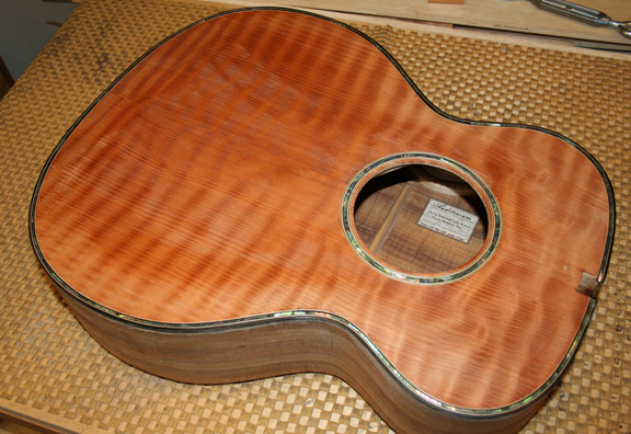

Here is my most recent redwood top. I thicknessed it to 0.113. based on deflection testing. Keep in mind, my tops are generally thinner than most tops

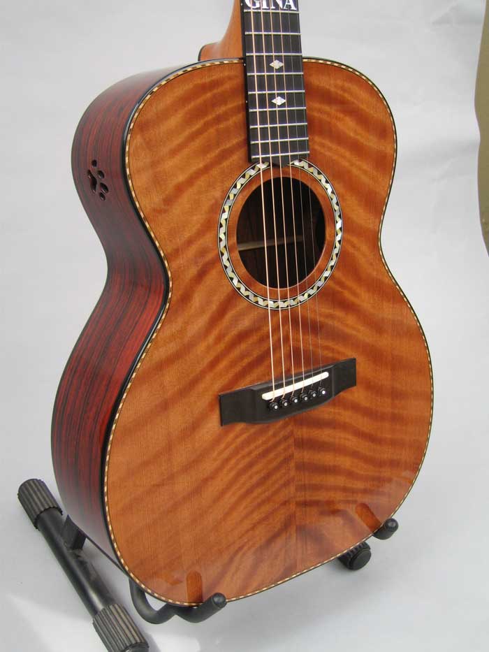

I've built around 30 or so redwood topped Mayes Guitars. and a couple
dozen redwood topped ukes.... Love redwood for ukes...

Ok here are a couple of many...
PostPosted: Fri Jun 22, 2007 8:05 am
lets try that last one again....
